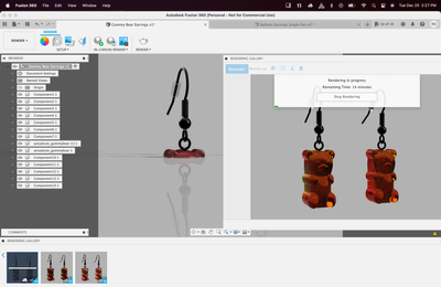

Why is the ground cutting off my objects when I render? In the render screen on the left it shows it right, I have the objects sitting on the plane in design mode, but when I render the ground is up covering my objects?

So adjusting that does adjust the ground…but do we really have to guess where to put it and hope it eventually gets in the right spot? The main windows preview and then the actual render are completely off. On another file I tried I pulled the ground completely over the object and it still wasn’t high enough to even start to see the ground…

jhackney1972
You do not have to guess, if your design environment model in on the X-Y plane and you set the Ground Plane to 0 in the Render Environment, the rendering will place the model on the ground.  Since it takes time to render the image, I did not do it in the video but simply attached the result in an image using the setting mentioned.  I am using In-Canvas rendering.

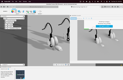

Here’s another file that as you can see, I’ve adjusted the ground to where it’s almost covering the objects…and the ground is nowhere in the render. Ground plans and reflection are both ticked. Tested on my MacBook Pro and Mac Studio and it’s the same issue one all computers.

Objects are positioned on the axis’ correctly. As you can see there is no ground in the render.

jhackney1972
I now see your confusion.  The video will show you how to compensate for the ground plane position with accuracy.   As I said, I have attached the result of a Local Render to prove it works.Render to Ground Plane1.PNG

So, I have to raise the ground 75mm to have it in the right spot...how can this be fixed?

P-BvanWyk
@royalcask,
The XY plane in your design workspace is by default used as the ground plane for renderings.
And it looks like you have a ~2.1mm offset.
The "Re-Anchor" @jhackney1972 mentioned worked on my side.
For future assemblies, I would recommend that you design & ground your base component on the XY plane.
This should completely eliminate the need to adjust the ground plane in the rendering workspace.
