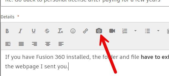

If you have Fusion 360 installed, the folder and file have to exist.  You probably failed to read this sentence from the webpage I sent you.
By the way, do not use external file links to attach screen captures, use the icon on your Forum post to attach them as I do.
