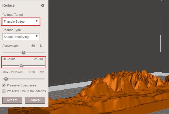

Hi @Anonymous
Thank you for sharing Smiley Happy it was happy to talk to you!!
Your STL file is over 130MB and I think it's such a big file so I tried to reduce your mesh data usign Meshmixer and It worked. you should find an appropriate mesh size.
Here is how to do it.
1. Install Meshmixer : http://www.meshmixer.com/download.html
2. Size reduce and Export STL :  https://youtu.be/921cDYBpuL4
I reduced your model to half size and it opened. could you try with my attached file?
