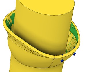

Hi all,
The problem seems trivial, but I am a complete beginner, and cannot move forward.
I have two preservative geometries which I want to connect with a starting shape in order to give a more desirable result. Without the starting shape, the previewer can run without a problem. (See no-starting-shape.png)
When adding the starting shape, which is a hollow body build from a 3D-scan of a leg, the previewer fails. (See w-starting-shape.png) The starting shape is cut with the the perservative geometries, and meets the surfaces perfectly.
Let me know if more info is needed, and thanks in advance.
Best,
Edvin

I played with your study some and I believe the issue here is related to thin sections in your preserve bodies. When I try to generate, the generative solver complains that the shape it was provided isn't connected (that is, there are several different pieces of geometry, some floating in space; they refunded my cloud credits, though). The generative solver is looking at a voxelized version of the geometry, and sometimes thin pieces of Fusion solid bodies are too small to be represented by a single voxel-wide wall. This is probably why the previewer was failing. You have a few options:
  • Increase the synthesis resolution. You've already maxed that out on the study you posted. This won't help the previewer but will reduce the chances of a failure when you generate. The higher your synthesis resolution, though, the longer the solve takes.
  • Thicken your preserve bodies, particularly the top one.
  • Option 2.pngExtend your starting shape so it covers the preserve bodies and creates a thicker initial structure. This might still fail later in the optimization process, if the solver tries to remove material until only the preserve is remaining, but the solve at least starts.
I'm running the last two options now, and a dozen iterations in they look alright; I'll report back when they complete.

Even though Preview fails for the file you posted, I tried it and it seems to be generating fine. The starting shape you're using has some thin sections, and I think the coarse resolution supported by the previewer is unable to represent the shape adequately.
Here are the results from the studies I ran yesterday:
One quick comment - you don't need to both make the starting shape cover the preserve bodies and thicken the preserves themselves. Either method ensures that there's enough geometry there at the start of the optimization process for it to not immediately break in pieces. The thicker starting shape with the original preserve definitely did have trouble representing the preserve body in the solver once the starting shape started to erode. Here's a snapshot from an early iteration of this case; the preserve body is only partially represented by the solver.
