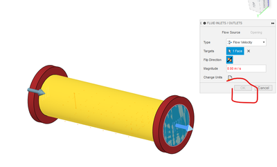

After setting up in inlet with a speed, the option to select 0m/s for the outlet cannot proceed.

I have sorted it. Had to set pressure to 0 instead.
