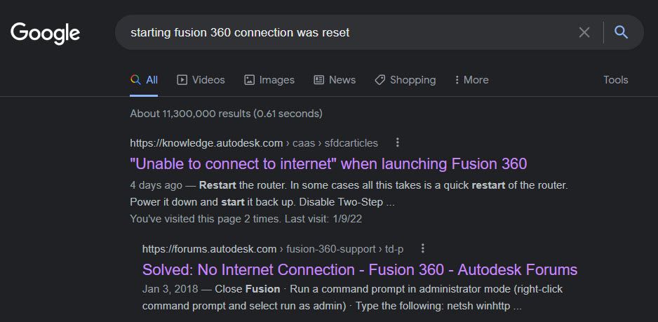

The log files says the connection was reset.  Do a search using Google for the show phrase and look at both the articles I am showing in the screen capture below.  As far as the Firewall settings, I would temporarily turn off the Windows Firewall to see if that is the issue.  I have also heard of issues due to the Autodesk Desktop App running.  You will find it under the Autodesk Folder in your program listing.  Stop it and try running Fusion 360.

I tried your suggestion regarding the firewall and it worked !
For some reason Kaspersky was blocking Fusion 360 though I did not even open Kaspersky for months. Then I tried to add Fusion launcher and other files to the exclusion list but Kaspersky kept crashing each time so I ended up reinstalling it again which seems to have solved the problem entirely.
