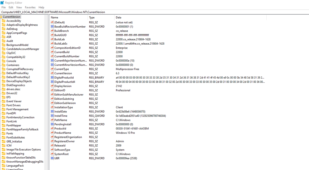

CoastLineModels
OK this is what I've got from Regedit:

lance.carocci

lance.carocci
@CoastLineModels thank you the information.
I can confirm that the overall message is accurate - your version of Windows 11 is no longer supported by Microsoft - but for some reason that build was incorrectly identified as 10 in the user-facing string.

Looking at my detection logic here, I speculate you are on a build older than <19000, and it looks like I mistakenly left out this range of build numbers. The only build of Win 10 with mainstream support currently is 19045, aka 22H2 - I would update to this as soon as you are able.
