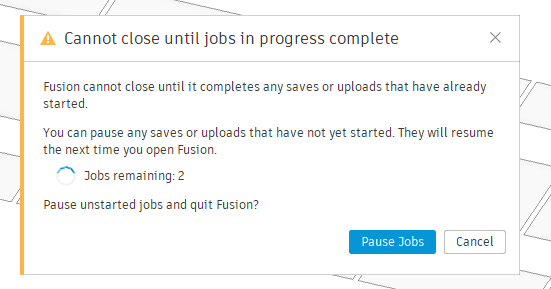

Fusion freezes for more than a minute every time I close a assembly file after saving it. Normal files seem to close normally. Overall fusion seems to be running pretty slow and buggy as well. I've made sure my Gforce driver is updated, but that didn't change much.
Also if I try to shut down fusion it also keeps telling me I have 2 jobs remaining even though there aren't any.
I've tried clearing the cache but he still keeps saying it.

@Chronix_07 We can certainly look into why it is slow but would like to understand more about the buggy part. Can you elaborate on what kind of issues you are facing as buggy?
Regarding the jobs remains, can you please do the below?
1. Close Fusion and ensure that task manager is no showing any Fusion.exe
2. Go to Add/remove programs - Autodesk Fusion - MODIFY
3. This will launch the Fusion service utility
4. Run the Reset Fusion
5. launch Fusion again and close it immediately
6. Does it still show the two files remaining message?

Hello Rajkumar,
I've tried what you said and it solved the problem with the job remains. Thanks, I will keep the reset fusion in my problem solving toolkit from now on.
