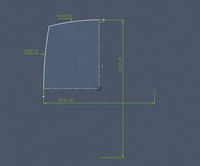

Yep, and you already made several mistakes in your sketch:
1. Not fully dimensioned and constrained.
2. The above can be difficult or labor intensive to do with fit point splines, but those are hardly needed for this project.
3. You mirrored inadequately constrained and offset splines. Mirroring entire sketch halves / quarters is not a good practice. Outside of using large patterns in sketches,   mirroring inadequately dimensioned and  constrained and offset splines is the best way to kill sketch solver performance.
Two arcs, and extrusion and a solid fillet on the edge makes for a much more efficient workflow that is also a better reflection of the geometry.

If you take a look at the model I posted, you'll find that my approach is quicker than what you created, but it is also fully constrained.
If you must use splines, then the two arcs can be replaced with  3-degree control point splines.

I would not use ANY mirror constraints.
Instead I would use Midpoint constrained Construction Lines to locate the spline nodes before creating continuous spline.

I must argue my original design, since the splines were surrounded by fully-constrained and tangent to the construction lines, allows me to adjust the width and length of the bowl and the smooth curvature is still maintained. I ended up having to do that because the final product was 2mm too tight. I changed my variables and the splines followed the construction line. I also got around the crashing issue by drawing my lock tabs on a separate projected sketch.
In your example, you used radius to constrain your arcs, making it hard to make adjustment in the future. If the bowl length needs to be increased by 2mm, those radiuses are locked.

Fully defined sketch.
Curvature display at the corners, but there will also be abrupt change at the top/bottom and sides.
No Mirror Constraints.
(I accepted the default handles - they could be edited if needed to further control the spline.)
