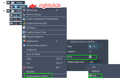

Hi!
I noticed this issue quite often: These artifacts or graphic clippings always appear on larger circular objects. They occur on edges or surfaces. Sometimes it is just a visual bug, sometimes they also translate into the exported stl or 3mf file.

g-andresen
1. change this display setting
2. STL options
günther
me
Ah nice, I didn't notice the display detail setting, that fixes the visual issues. As for the Refinement Option, I already used the finest settings there before.. I'll have to see if it occurs again on export, because I don't remember which file it was. Thanks for the support!
