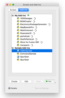

Can you please provide a screen shot of your loaded add-ins? Like this?
 Here's a screen shot
Phil.E
If you try setting each of your installed add-ins to not run on startup, one at a time, and then restart Fusion, it should help figure out which of the add-ins is causing it.
