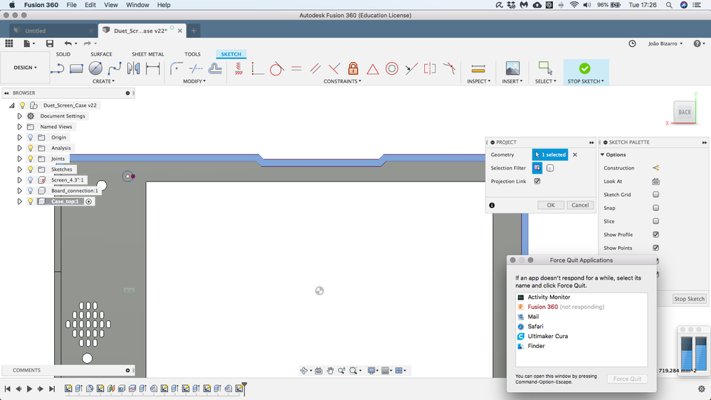

Fusion 360 freezing every time I do basically anything, normally when sketching and projecting geometry on sketch. Already re-installed fusion, but the problem still remains. Help please!!!

Hi @Anonymous
Can you please post the file so we can try working with it? Does Fusion crash with other files or just this one?

Message 4 of 18
with any file. i've tried with other projects and the problem is the same.

Message 8 of 18
thanks! I've clear the cache and did a diagnostic log. here it is:

Message 10 of 18
karina.harper
Autodesk Support
Autodesk Support
@Anonymous
It looks like this is a graphics card issue that is happening particularly with older macs.
I did some research and you might try updating your NVidia drivers - here's a forum thread that has some directions to update the drivers that provides better performance. If you try this, will you let me know how it goes and if it fixes the issue?
Thanks!

Hi @Anonymous
You might try:
  • Updating to OS 10.14.
  • You could also try changing a preference setting in Fusion.
  1. Go to Your Name menu, upper right corner
  2. Pick preferences
  3. On the first page, switch graphics driver from Automatic to “OpenGL Core Profile”.
If those don't work, then updating the graphics driver is probably your best bet. This may have been triggered by a recent update, and it has been logged. Our team is looking into it.

@Anonymous
So you're unable to update to 10.14? What OS are you currently on?
Message 16 of 18
!0.13.6, but at Apple they say my Macbook Pro (mid 2010) isn’t updatable.

@Anonymous
Ok I see. Thanks for clarifying.
I think your best bet is updating the graphics drivers. Like I said we're looking into why this is happening, but that will take some time to figure out.
Updating the drivers shouldn't do any harm to your computer - this is a standard operation if you have a PC and in my mind it's surprising it doesn't get talked about more in the mac community. If you look through the thread I linked, everyone had great results with the driver update.

Hi Karina,
many thanks!
I've tried to install the driver but with no success.
I just have to wait until the next fusion update and hope it's fixed.
