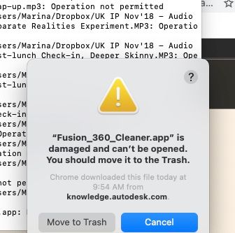

Hi. @g-andresen  and @dsouzasujay  when I try to open the cleaner app this message comes out:
 Any ideas on why this is happening or any ideas to solve it?

Ian.alvarezg
Hi, @dsouzasujay after following the steps you proposed and trying to open the cleaner app this message poped up:
 Any ideas?
