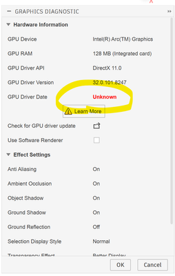

Hello Fusion 360 Community,
I am experiencing a persistent graphics compatibility issue while running Fusion 360 on my Lenovo laptop, which is equipped with an Intel Arc 140V GPU (Lunar Lake).
My system is currently using the Intel Arc graphics driver version 32.0.101.6881, obtained directly from Lenovo’s official support website. I have also tested newer Intel Arc driver releases (including 32.0.101.8132 and 32.0.101.8247), but unfortunately the issue has not been resolved.
What makes this particularly frustrating is that I have seen Fusion 360 run smoothly on older entry-level laptops, such as Dell Latitude models with modest CPUs and integrated graphics, without any compatibility problems. By comparison, my newer hardware struggles to achieve stable performance.
For reference, I have attached a screenshot of the Graphics Diagnostic window from Fusion 360, which shows the current configuration.

Hi @lance.carocci , thanks for following up. The compatibility issue I’m facing is that Fusion 360 becomes unstable when using my Lenovo laptop with the Intel Arc 140V GPU. Specifically:
  • The viewport often freezes or lags when rotating or zooming models.
  • Even with updated drivers (currently 32.0.101.8247 from Intel), the performance is inconsistent compared to older laptops I’ve used with integrated graphics.
  • In the Graphics Diagnostics window, the GPU RAM is reported as only 128 MB (despite the Arc GPU having 18 GB shared memory available), and the GPU Driver Date field shows “Unknown.”
I’ve attached the Graphics Diagnostic screenshot to show my current configuration.
Fusion 360 Screenshot 2025-11-08 110807.pngIntel Screenshot 2025-11-08 110907.png
Could you confirm if this is a known limitation with Intel Arc GPUs, and if there are recommended settings or workarounds to improve stability?
Thanks again for your help.
Message 4 of 20
lance.carocci
There aren't any known limitations with Arc graphics. 128MB is just the minimum reserved amount of dedicated memory - this metric tends to be more useful for dedicated graphics.
The driver date field is an unrelated issue.

Hi Eder.Casto,
Did you resolve your issue? I am having similar problems too.
Toady I fired up my old laptop and compared the Fusion Graphic Diagnostic
I noted that the graphics diagnostic on the new PC says 128MB, but i have a 18GB Vram installed on my PC. Whilst the Fusion graphic diagnostic on my old PC say's 2GB which is compatible with the PC graphic card.
 Why is it showing incorrect GPU status? Is this the problem? If so, then I need to find out how to force Fusion to see the 18GB Vram GPU.

lance.carocci
So, are you saying that it not a problem that Fusion say's 128MB when the GPU is 18GB?
Correct. This value is being reported to Fusion from the OS, and the OS says the GPU has 128MB of dedicated memory. It does not reflect the current, dynamic VRAM utilization.
If you were to watch Fusion's GPU memory usage in Task Manager (Details tab, with both Shared and Dedicated GPU Memory columns enabled) and a detailed model open, you will see far more than 128MB in use.

lance.carocci
Thanks @Eder.CASTRO, I've confirmed the driver date is a cosmetic issue on our end and should be fixed in a future major (as opposed to minor) update.
The Offline test was more to confirm that some of our web traffic isn't interrupting the UI (which often looks like low framerate if it happens repeatedly for milliseconds at a time). It sounds like that is not the case.
Would you be able to record the experience you are facing?
Broadly speaking, modern integrated graphics will be able to do most modeling, but depending on the complexity or size of your model, performance of the graphics canvas can still be impacted. Personally, on my UHD 620 graphics running 4k@60hz, I use a custom preset with all the details on High, but a navigational framerate threshold of 60 so that all detail disables briefly during canvas movement, then restores when stationary.
The biggest impact to framerate is generally going to be Anti-Aliasing followed by Ambient Occlusion, so you can try disabling those specifically if you like.

Eder.CASTRO
Hi guys,
Just a quick update — after installing the January 26 Fusion 360 update, the error message and performance issues on my Intel Arc system are gone. Everything is running smoothly now. Thanks to the Autodesk team for the support and follow‑up @lance.carocci @LishuangLu.
