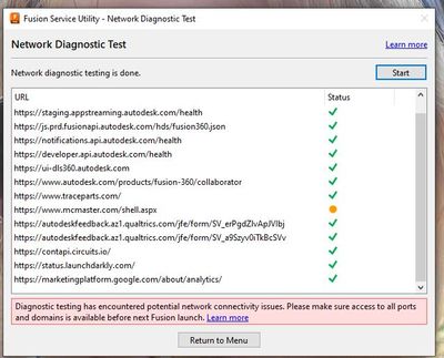

tommyscustomshop
Hello, Rajkumar hope all is well,
    I did what you suggested and reset Fusion with the same results just as when I uninstalled Fusion and reinstalled it, I also ran a diagnostic test, and here are the results (Photo)
Tommy
Message 4 of 16
RajkumarIlanchelian
@tommyscustomshop The logs shows a ton of errors that could not establish connections. Did you try the reset of router and also another network? I will keep looking at the logs for more information.

Message 5 of 16
tommyscustomshop
 I reset the network and the same freeze happens. What I do not understand is I completely uninstalled Fusion twice now and reinstalled it twice now and still have the same results is there a way to install Fusion without the latest updates?
Message 6 of 16
RajkumarIlanchelian
@tommyscustomshop Its certainly not the update and No there is no way to roll back. Uninstall and reinstall is really not going to help here. It's certainly not connecting well with the network.
Is there a possibility for you to connect to another network and see if that helps? Where I am going with this is there could be a proxy or firewall as well that is blocking the access (we recently had a customer very similar to this situation and it turns out that the firewall in their ISP provider all of a sudden started to black Fusion calls). So I a trying to eliminate various pieces here to see where the problem is.
