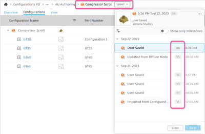

@amagrude Since you're working with Configurations, there are a couple of things you may want to check regarding the version numbers and naming.
Version Numbers
  • The Configured Design (CD) and its individual Configurations have separate versioning logic, so the numbers won't always match.
  • When you save changes to a Configured Design (CD), the CD itself always gets a new version increment.
  • However, only the Configurations that were edited during that session get a new version increment. So, if you didn't edit a particular configuration during that session, its version number remains intact. This is how some configurations have a lower version number than the CD and/or other configurations in the same set.
  • This logic prevents unnecessary updates to configurations that haven't actually changed.
  • You can find more info about this here.
  • You can verify and compare the version numbers in the Fusion web view.
Naming
  • There's a user preference that lets you control the display of Configured Component names in the browser, which you may want to check.
    • Click your Profile Picture > Preferences > General > Design > Configurations.
    • Select the combination of CD Name, Configuration Name, and Part Number that you prefer.
  • From what you described, it sounds like you could be experience a rename issue with configurations.
    • When you reopen the source Configured Design, does the renamed Configuration also revert in the table? Or does the new name show up correctly there?
    • If they still look correct in the Configuration Table but not in the browser of a design where they're referenced, there might be a problem to look into.
