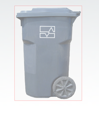

This is the canvas image after you are modeling the garbage can after.
In Fusion 360 I would not model this with T-Splines. Not that it can't be done, but it is easier to do with the solid modeling, or surface tools.
