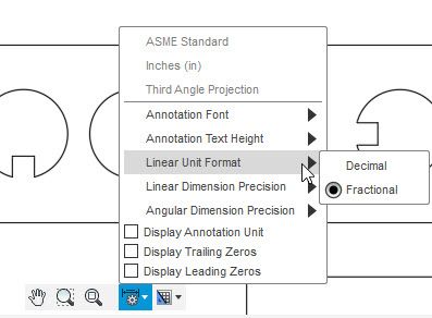

Looking for previous questions I see that drawings can not be done in fractional dimensions, but I am pulling up old questions.  Has Fusion been updated yet to show fractional dimensions?  I am making a bunch of drawings to send to a shop floor and I can't expect the fabricators that are working with tape measures to convert every one of the thousands of dimensions to fractional with calculators.
Also, can a suffix such as " or mm be added to the dimensions?

Fractional units can be configured from the Annotation Settings at the bottom of the drawing screen.  The dimensional unit string do not show unless you are using dual dimensions, then the second dimension shows the dual dimension units.  Your title block normally specifies the default units of the drawing.

Thanks jhackney. I never noticed that at the bottom. I don't do a lot of drawings from within Fusion. I tried it and works great.

In one of the Fusion 360 updates, the drawing Document Settings were moved from the bottom of the sheet to the top of the browser.  Expand this and you will find your settings.  This change was outlined extensively in the What's New blog which is displayed with every update, be sure to read it every time.

I think you will find it is still there under Document Settings in the 2D drawing environment.  I checked on both subscription and personal license versions of Fusion 360

Thanks @jhackney1972, I'm looking for fractional in the `design` view.  I'm a total novice, but I'm not done yet with my design to make drawings so I don't think I'm ready for that yet.  I'm working on a bathroom remodel, so I was hoping that I had the ability to display in understandable (fractional) dimensions while I worked on the re-design.

Your question appeared under the forum thread talking about fractional dimensions in the the 2D drawing, that is why I responded as I did.  You will not find fractional dimensions in the model view, but it does not matter.  You can enter any fraction just by typing in the fraction when you are entering dimensions.  For example for .375" just type 3/8 and the program will convert it.  There is a math accumulator built into every entry box.  For a mixed number such as 1 3/8" just type 1 <space> 3/8 and it will give you 1.375.  It makes entering 25/64" a breeze for us machine designers.
