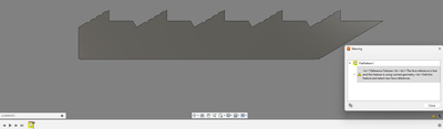

Hello Fusion people.
I will report bugs and odd behaviors I run into on this forum. I will make a habit out of this so here is my first one :
Inside the flat pattern i have a warning telling me that the reference is lost. I have no clear indication in the design browser tree that there is a problem with the flat pattern. No warnings when i save either. Can i trust a drawing referencing that flat pattern? I don't know. It seems like the drawing references ok but do I trust it? No.
Do I want to go individually inside every flat pattern in order to confirm the integrity of it? Not really
Should the browser tree UI give me a warning that something might be wrong. I would think so
https://www.loom.com/share/330e3425639a441a83a1fa3b46686d43

I see you have a workaround of Save then Flat Pattern...Do you get any warnings after Close then Reopen and straight to Flatpattern? (What Screen Capture software is that?)
3d_low
No warning nowhere unless i play hide and seek inside the flat patterns.

@TheCADWhisperer the file has proprietary data so i can't just share it freely on the forums
TheCADWhisperer
@3d_low
Can you reproduce the behavior in a dummy file that does not reveal any proprietary data?
Replication has always been the Gold Standard in the sciences.
3d_low
don't mean to be a D but i don't really have the luxury of time to clone stuff.
I'm really just posting it here so ADSK people can have a look, log or contact me for access to the designs.
