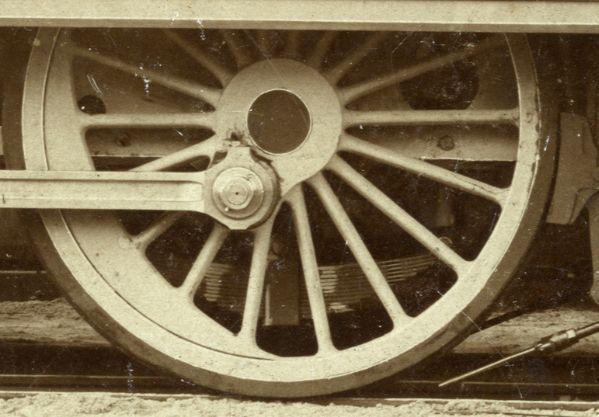

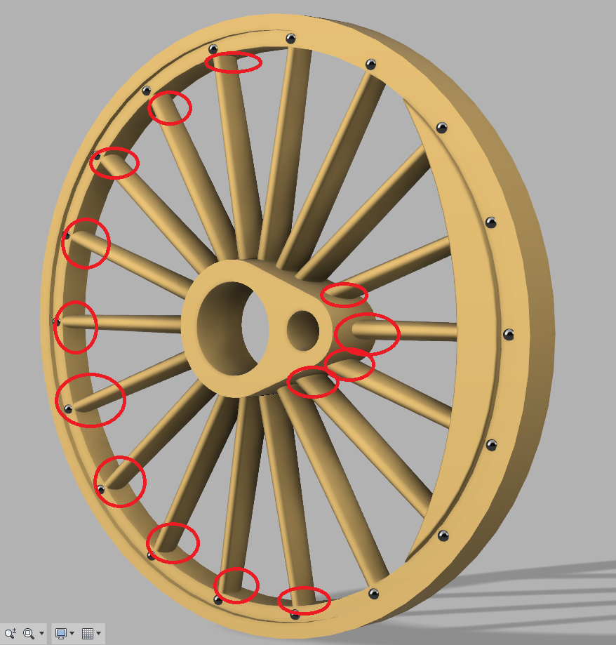

I need to make a scale steam locomotive wheel and for the most part it's pretty close, but I can't get the point where the spokes enter the rim and the hub look right. I hoped to get it right with "Fillet" but that doesn't work. "Sculpt" didn't work either...
Can anyone of yoy guys give me a hint on how to proceed?

Are you will to share the model?  I am happy to take a look and make a video of the workflow that I would take.

The workflow to get what you are looking for is fairly advanced.  I first combined both of the bodies so that I could put a fillet between the two.  The fillet causes the circular shape to loose form, so I created a sketch and cut away the fillet area.  Next I split the face of the inner circle for my loft profile and sketched a line for a rail to keep the loft straight.  Finally I created a loft using the two profiles, edges and sketch as a rail.  Here is a video of the workflow and attached is the file.  You can then pattern this and repeat for the outside.
http://autode.sk/2xkRntu
