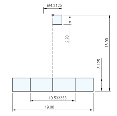

The height of this part is 2.05625" and width is 4.1125". I put a 2.05625"  fillet on the edges but it doesn't make a perfect half circle.
What am I missing?

This is what the part looks like. The end with one outlet has a height of 2.05625" and the 4 outlet end has a height of 1.6". I am using a variable fillet.
You can see that the single outlet was extruded before the fillet was applied and is the same width as the middle body but slightly higher.

Fillet has done what you asked for.  Fillet radius is normal to the Path.
The intersecting faces for that filleted area is elliptical at the duct face.
For a concise curved boundary between outlets on that model, you will need a sweep with Guide rail, or Loft.

Split body the larger end, then Loft both ends together.
One way to get there, may not be what you want.

I made some changes to your design - see Attached...
First thing I noticed is that your Sketch1 was not fully defined or making use of obvious symmetry about the Origin...
Version 2 with different Loft weights and Fillet.

I kept the straighter edges and leaned on surface tool to erase, patch and stitch. This is very close to the original shape.
