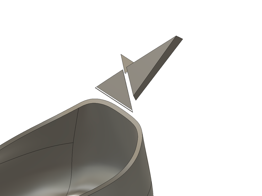

I created a shoe w/ t-splines then thickened it to make it a solid and added a ridge around the shoe opening.  I cannot create a fille on the ridge as shown below.  The f3d file is also attached.  Does anyone know what I need to do to make the fillet?

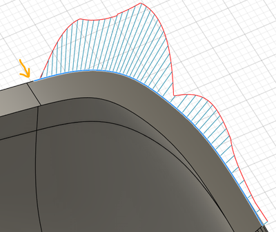

jeff_strater
yeah, you definitely have some funky geometry/topology in this model.  In addition to what @TrippyLighting says, another good thing is to try to turn on curvature comb analysis on the edges in question.  You can see here that you have some wild swings in curvature, around that same edge:
particularly in the area indicated by the arrow.  I suspect that is the source of the fillet issues

mrabushka
I don't get any funky curvature comb geometry on the top edges where I want to create the fillet.  I do get it in the section below, but I'm not trying to modify that section.

jeff_strater
ah, you are filleting the inside edges.  I missed that in the image.  I do, though, see similar curvature concerns.  The edge that is highlighted by the Fillet command does have a lot of curvature, which can cause Fillet failures:

mrabushka
It's strange that when I highlight part of the edge I get wonky curves, but if I highlight more of the edge, like the section pointed to by the orange arrow, then the curve is tamed.

jeff_strater
The way that the curvature comb works is a bit funky.  The default "scale" is determined by the number of edges/curves selected.  I think that is the only difference between your two images.

There are some tools in Direct Modeling that can help.  Just to see what happened, I selected some of the faces (I think it was a different set, but basically these +/- a few:
And I just deleted them.  In Solid mode, Delete of a face or set of faces is "delete and heal".  I really had no hope that would work, but it did produce a slightly better set of geometry, with some very weird "extras" that worry me a bit:
The first time I did this, I was able to just select and delete most of this geometry, but the "most" part worries me, and when I tried again a second time, Fusion crashed...  So, beware, and save before trying this.
But, I was then able to put a 0.7mm fillet on that inside edge:
This model is attached.  But, as I said, I don't have a ton of confidence in this geometry, so be a bit cautious with it...

mrabushka
Thank you @jeff_strater!  I was able to eventually delete the stray geometry in your attached f3d file w/ a bunch of clicks and deletes.  Then I deleted one more face, shown at the red arrow below, from your model:
Then I was able to create a 0.96 mm filet along the inner and outer edge to create a nice round lip w/ the filets meeting in the center:
So you solved the issue.    Thank you!  For those following -> It was just a matter of deleting enough faces in Solid mode which Fusion 360 healed on its own until I could create the filets I needed.
