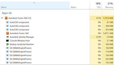

@dlewis1000 Can you post a screen grab of the 17 process that is running? It looks like you are close to reproducing this more consistently but it would help to understand what are the process that you see running.
A machine restart is also a good way to flush out anything that is hanging on to the system.

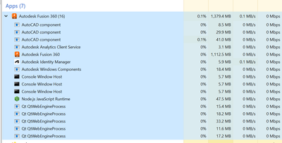

@RajkumarIlanchelian  I can't seem to recreate the same 17 but now there's 12. Before there was more of the autocad component and QTWebEngineProcess that made up the 17.
Again it seemed to work after clearing cache for a 2nd time and then after the first close the issue comes back. Every time I save a new version it gets stuck in limbo. If I open the version list and open V1, it asks me if I want to open the locally saved file. Keep in mind the 3 little dots next to each version only show up on V1. When I open that locally saved file it seems to kick it into gear and the version number in the list updates to what it's supposed to be.

@dlewis1000 Thank you for adding the image. I am going to look for what could be happening here.

1. Close Fusion 360 until there are no more tasks in the Task manager
2. Launch Fusion 360
3. Take a snap of the task manager
4. Open the file
5. Take a snap of task manager
6. Edit/save
7, Take a snap of task manager
At this point are all the extra events starting to launch?

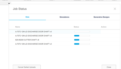

The job status never shows a job, the progress bar at the bottom of the data panel never shows up, but it saves fine and when I close it it doesn't show reserved or with the error.

Same as before where I don't see it in the job status but it seems to save fine with no errors still.
