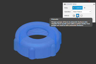

Hi all,  Any suggestions on how best to convert STEP file from Fusion360 to an X-T file or IGS file?  I am working with an injection mold supplier that says they cannot use my STEP file from Fusion360 because it contains "too many surfaces".  These are the normal triangular surfaces from the mesh.  The supplier said X-T or IGS file will work fine, since they don't have this mesh.  They also said an STP file is fine, but it should be a solid body without mesh surfaces.  Any help on this would be much appreciated!

Sounds like the problem is you've converted a mesh so any file format will be a problem. Can you share a screenshot of the part?

Hi, thanks for your reply.  Yes, I created the STEP in fusion360 by first importing STL mesh, and then going through export process to make it a STEP file.   I'm not clear on how to make it a solid body (no mesh), prior to exporting as step.   Attached is a portion of the STEP file image, which shows it still has mesh.   Appreciate any help!
Message 4 of 9
HughesTooling
That just will not work, all you've done in convert a mesh file into a faceted sold model. You will probably need to recreate the model from scratch, although Fusion can convert simple meshes to surface models it's very limited.

ok Thanks.  For the convert mesh process, I have tried to use the prismatic feature in Fusion360, but it fails.  I think the model is too complex.  So I used "faceted" option, but as you said, this does not generate the solid model needed.  I was informed by my injection mold supplier that they can accept X-T file format.  Any suggestion on how to covert my STEP or STL into X-T?  Much appreciated.

Changing file format will not correct the fact that the geometry is not modeled correctly.
Can you Attach your original file here.
Message 8 of 9
HughesTooling
What program created the mesh you're using? Does it have any other export formats that are not mesh based? As @TheCADWhisperer  stated using different formats to export from Fusion is not going to fix your problem. If you only have a mesh to work from then you'll have to remodel in Fusion.

Good point from both of you.  My file was created tinkercad, and exported as STL.  Should I export in another format (like OBJ, SVG, GLB)?  Those formats are available in tinkercad for exporting.
