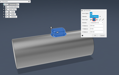

I am not at my Fusion machine to test, but can all of the faces of a feature be Window selected?
Message 9 of 9
TrippyLighting
Yes, but you'll first have to change the selection filter to "Faces":
And then use the red-circled option so the move operation is parametric.
