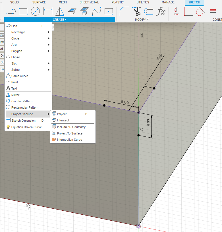

Having a new tool isn't bad but what you want can be achieved easier than above steps (which work only for a cube and not a generic corner).
For equidistant you can follow @Steven_Gao 's screencast which is very easy (if you need X mm cut from corners apply a X/2 mm chamfer to its edges, then delete 3 faces). For multiple distances you can make sketch on one face, Include 3D Geometry and select edges, put a Point on each edge at the required distance. Finish sketch and make a Plane Through Three Points. Use this plane for Split Body, and Remove the unwanted body.
I have attached an example file.
