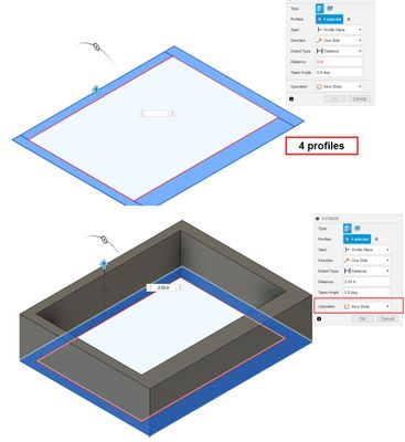

I wonder if there are any specific setting that would allow me to extrude multiple profiles at once? From my attempts to do so the way I would intuitively think it doesn't. Selecting "New Body" as operation I was hoping that would be the end result, but I'm left with a single body... no difference as if I would of select the "Join" operation...
Any advices? Thanks

As the profiles are connected to each other, they also form a single body. The option to extrude 4 single bodies is currently not available.
