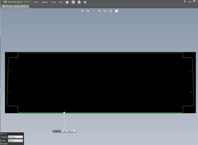

Here is the export I've done from fusion :
Here is the dimension mesured on e-drawings from the exported file :
I've noticed that if I open the exported dxf in fusion rather, then the dimensions are correct. However, I've never seen this behaviour in any other CAD software, which makes me believe that it comes from Fusion 360 ..

HughesTooling
No, the problem is the viewer is assuming the file is in inches and is scaling it, I expect if you set the units in the flat pattern to inches the viewer will show the correct size. Try downloading QCad for a viewer.
If you're sending the file to someone for manufacture you might be better off using your 2d Drawing workaround so you can specify the units on the drawing.
