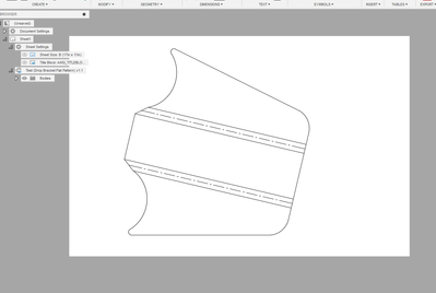

Exported DXF has misplaced lines as viewed by several programs. There seems to be no actual solution in the forums, these threads go dead. What's the issue  here?

The problem with this is that the bend lines do not translate to Send Cut Send, for example. What would be the best solution here?
Converting the projected bend lines to center/construction doesn't seen to work, only thing I could think of trying.

What's problematic is that creating a sheet metal body from the derived sketch still produces a broken DXF file, even if it rebuilds the bend lines that SnS for example can now find again.
Fusion is bugging out on creating what is, in reality, a really simple flat pattern and knowing WHY and how to PREVENT this is what I'd like to focus on in a solution.

As an addendum, exporting this bracket in STEP, bringing it into Solidworks, and converting to sheet metal allows me to flatten and export a functional .DXF file.
So, seems to be a problem with Fusion.

Are you a commercial user or using the personal licence? If you have a commercial licence then I'd suggest creating a support case through your account. What you're seeing is a very old bug where elliptical arcs are output incorrectly. I have reported these problems several times over the last few years!
What you can do is recreate your part using arcs and it will work fine. The difference between the arcs and elliptical edge are very small.
I've attached your file where I projected the faces edges from the original bracket into a sketch but used an arc rather than project the elliptical edge. See attached file.

@phillipJSCHJ From reading your posts I think you have a commercial licence so a better option is to create a 2d drawing then export as a DXF.
This is the drawing workspace with a 1:1 scale and tile and border hidden.

Thank you for the second look and the bug identification. This fix produced a functional .DXF.
It doesn't give me warm fuzzies that Autodesk hasn't solved this bug after several years, however.
