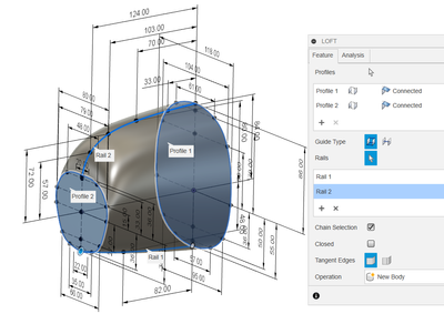

I created 2 sketches from 2 canvases (F1 and F4) that I imported on 2 different construction planes. I then connected the 2 sketches with 2 rails. The rails follow the outline of canvas Fuse Side. Then I loft the sketches and select the 2 rails I get the "Modeling Error: Rail(s) cannot be tangent to profiles!".
I have made similar loft's in the past but I found that this error started to appear since the last update.
Can someone please tell me how to fix this problem.

Thanks for sharing the model, @hdeubler .  I agree this looks strange.  I thought it was the curvature of the top profile:
but, even calming that down a bit does not help.  I'll have the modeling kernel team look into it...

First thing I notice is white dots (missing Coincident connections - these are absolutely critical). White dots should keep you awake at night.
Then I notice that splines appear to be mirrored rather than tangent continuous.  (Common mistake.)
And finally, I notice that (missing) dimensions cannot be measured in the real world (unconstrained sketches).
So I take care of those issues.
I would probably do this all a bit differently - but just following your lead...
See Attached...
BTW - haphazard sketching like this has always been unpredictable (or predictably bad).
White dots = no connections...
Fix the white dots (missing connections) and it will Loft.
TheCADWhisperer_2-1696334290545.pngTheCADWhisperer_3-1696334315195.pngTheCADWhisperer_4-1696334336245.png

davebYYPCU
White dots and blue sketch articles, are going to add to the frustration.
Loft is finicky, and you must follow the rules.
Your canvases are misaligned and out of scale relative to each other,
In CAD we build from the outside > in, and the workshop, Inside > Out.
So longerons for profiles, and bulkheads for rails,
Sneak up on the cockpit area.
Might help....
