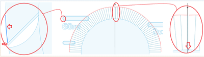

I am attempting to emboss a body from a sketch. The dialogue the preview indicates it should work, but the results do not materialize as expected.

TheCADWhisperer
@eric_strebel
Something strange going on over here.
Message 3 of 11
eric_strebel
Yes, I noticed that as well, it happens in the embossing.

TheCADWhisperer
@eric_strebel
Sketch8 is a bit of a disaster.
Simple slots are comprised of Splines and other oddities.
I would also fully define Sketch6 if it were my work.

TheCADWhisperer
@eric_strebel
Uhm, you didn't observe what Extrude2 did to your Emboss?
Click on image above to enlarge the view.

eric_strebel
ok, sketch 8, was a quick export. I agree has some issues. I will address them. That I can do that and fix it. Thanks
Please elaborate on fully defining sketch 6?? I guess I don't understand what would need to be done, to fully define it.

Warmingup1953

eric_strebel
Yes, I have access to that.....I am not familiar with that feature. But I get the jest of what it does. It constrains everything. Constraints are definitly not something I really use/grasp. Why is fully constrained  important?

Warmingup1953
Fully constraining your Sketches may very well be the single most important "thing" to dedicate yourself to in learning and using Fusion... it is very hard to overstate the importance!
Why?...Well, I'm no expert, but I recall being taught that at its heart, Fusion is a sketch solver, and if it can't solve sketches or if there are multiple solutions, unexpected outcomes can be expected!
FYI your Sketch 8 was it couldn't be Auto-constrained. Did you try my workaround around moving the Emboss to the right in the Timeline?

eric_strebel
Ok, I have cleaned that sketch up and moved the emboss in the timeline. It is orange and the only reason I think it works is because I moved it in the time line.
See new attached file.
