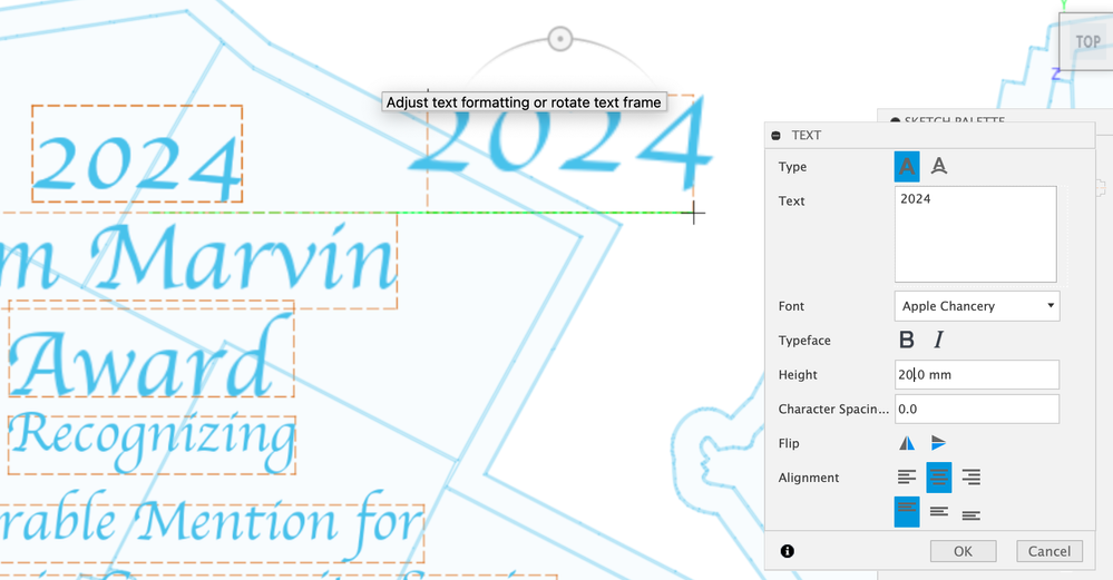

I am working on some text within F360 today and I'm getting multiple crashes when double clicking text to edit. I've had this happen 4 times in the past 3 days. The crash report immediately disappears so I am unable to report what is happening during the crash.
Also within the text editing window I've noticed that character spacing has disappeared. Is these something new about text editing that I am missing?
I am updated to the most recent version of F360.
Is anyone else seeing this crash?

I'm also seeing font sizing being off. If I create new text with a font size of 20 and compare it to some text that was there previously that should be the same font  and font size, it is not the same.
Screenshot 2024-05-30 at 9.03.00 AM.pngScreenshot 2024-05-30 at 9.02.07 AM.png
I'm also seeing some misalignment of fonts. Take a look at the 4 in the date below. the 2022 date was the original. I edited this to change only the 2 to a 4. The 4 is angled. I changed nothing else.editededitedoriginaloriginal

Thanks for providing the file. Unfortunately I don't have that font on my system and Fusion converts it all to Arial font.
What is the font used?
Also, you might want to delete that file now that I have a copy of it for our developers.

The font is named Apple Chancery, it is shown in some of the screen shots also in the text editing window. I’m working in a Mac, that is maybe why you don’t have that font.

I do not think this is related to the font being used. It happened several times with me today using an Arial font. I also is inconsistent and I have not been able to capture it while recording. I will keep trying and the next time it happens I will try to recreate it.
Message 11 of 16
Phil.E
Sounds like a timing issue. If it always happens when double clicking the text to edit it, try using the right click menu for a while.
If it crashes when using this menu to edit the text, then it's a font/edit problem. If it only crashes when double clicking to edit text, then it's a mouse/UI/input/timing problem.

that sounds close to what is happening. It does not crash when using right click/edit text. It only crashes when double clicking to edit text.
I does not explain when the font size and alignment were off in my first screen shots. Any idea on that part of the issue?
