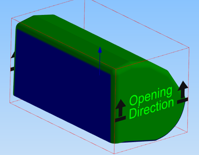

I had a face in between the 2 selected edges. I extruded (cut) the face but the edges remain. How do I remove them?

TrippyLighting
It isn't a surprise that this "design" does not behave as expected.
CAD requires precision and your workflow doesn't lend itself to that..
Are you interested in learning how to model "this" properly ?
If so, please explain what you are trying to model. Explain it's function (assuming it has one) etc.

TheCADWhisperer
What are you modeling (forget the core/cavity for now)?
Is this geometry aesthetically pleasing to you (red circles inside and out)?
Where are the sketches for this geometry?
Why is the geometry not modeled with symmetry about the Origin (negating the need for any Moves)?
I would also be concerned about Face Draft (inside and out) on this blue face in image below...
