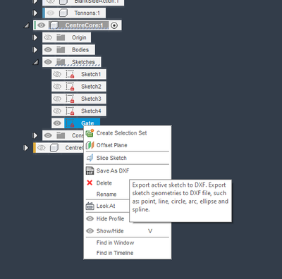

@grahamUTKMN  Are you right clicking the sketch in the browser and selecting Save as DXF or are you exporting the whole design? I'd guess you're exporting the design and your sketch is not on the XY plane, try using Save as DXF.

The export is a 3d file (all the information is in the DXF) so if you are opening the DXF with a program that only looks at the XY plane you're going to need to draw on the XY plane. If you have Fusion setup with Z up you'll need to design on the Top view on the view cube or if you have Fusion setup Y up use the front view. Or just ignore the view cube labels and make sure you're using the XY Plane.
