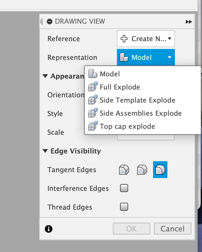

Hi All, has anybody had an issue where you can't see all of your storyboards in the drawing view representation box when trying to bring in an exploded view into a drawing as a base view?  in the pics below, I can't see "Base top view" and "storyboard 8" in the representation dropdown.  I've rebooted Fusion 360 twice, resaved the model a handful of times but still no luck.  When i look at the base view reference dropdown i'm only seeing versions of my design up to v35 but my design is currently v44.
Any thoughts on how to fix?

Hi, not exactly what i'm trying to do.  I have a drawing already with 28 pages which uses base views, animation views (exploded views etc) all within the same drawing.  in the past, whenever I created a new animation I could always reference it in my base views in a current drawing to build another page of my project plans with the exploded view created in the animation page.  For some reason this drawing is not referencing the most recent design version and I c an't figure out why.

Just for anyone else experiencing something similar, the issue was related to Milestones.
By selecting the latest milestone, all the correct storyboards were available in the drawing.
