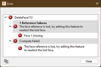

I have lost several bodies on my latest project. When i'm trying to recover them from saved sketches there are lots and lots of reference failures.

Quick update from our end. The dev team is aware of this issue and are treating it as high priority, they are currently working on a fix.

The team has identified the root cause of this issue and have released a hotfix. It should be live today, once you update Fusion 360 to the latest build this issue should be resolved.
Please let me know how you get on.
