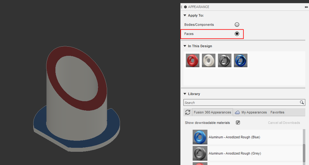

Another option that might work for you is add an appearance to the part in the design workspace then use a shaded view in the 2d drawing.
Design.
2D Drawing with shaded view.
