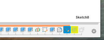

After latest update the history marker has started to disappear again after using the program for a few minutes.
Would be nice to get back - as the long time requested keyboard shortcuts for history marker moving forward and backwards would be nice to get.

Couple notes:
The timeline developers are looking into it again. No promise they can fix it but are aware freshly about the issue.
I know of three ways to reproduce this. Open the data panel when the timeline marker is off screen, or resize the Fusion application frame when the timeline marker is off screen, or press "move to end of timeline" button multiple times.
You seem to have active components with missing markers. Can you describe the situation to help me find any more reproducing cases? Now is a good time.
I also have found in these cases that you can make the marker reappear. Some combinations of opening data panel, or moving to end of timeline, or switching environments should bring it back.

I am still having this problem, history marker disappears and you have to use menu controls to move marker. I don't have an exact cause other than I notice it after having a file open for a long time (several hours) and moving around the timeline.
I know there are several threads with this issue in the past.
