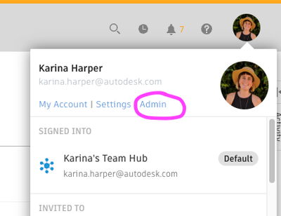

  • If you go to the 'admin' view of your hub, go to the 'projects' section. From there, you should be able to see all the projects. If you click on one, then click 'manage roles', make sure you have access to all of those projects.

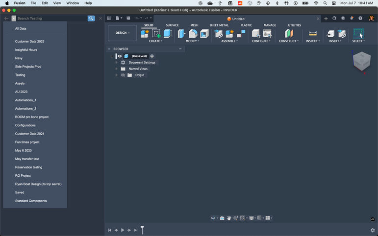

  1. when you're searching for files in Fusion, you are only searching in 'editable documents'. Change the search filter to 'all data'. It's the little gray arrow to the left of the search bar.
  2. When searching on the web, I see that you have a filter set to "shared with me". this might be impacting your search results. Change that to 'All Projects', and maybe try looking there again? It's quite suspicious that the search isn't returning anything with "5mm" when we can see that in the data panel as you are showing. There might be an error with Search on the web here. It seems to fail altogether for me if I have "shared with me" active in the left panel.
I'm wondering if the projects these are stored in you only have 'read' access for some reason. The 'manage roles' in that view should tell you/you should be able to make yourself an admin.

gubenco
@karina.harper
Thank you Karina, I did it! I do not know what exactly I've made but now I have a new folder called "project Admin" with all my old files and their versions, Everything is back! I think I have tried to "manage role" to a folder in my admin console. I have tried to change my account role from "editor" to "admin" (which did not change eventually)  also in the "team member" tab I have pressed the button with "Make project admin" I have seen a green bar on top of the page with status change and a whole new folder appeared in the left with all my old files. It makes no sense to me but I am happy anyway. Now I prepare to save everything on my pc, I will export everything as fusion archive, a thing I just learned recently is possible. Thank you @karina.harper  and @RajkumarIlanchelian
