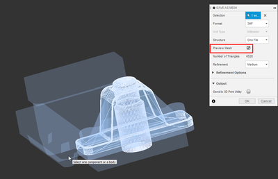

jhackney1972
Please attach your model.  Also, are you exporting to FDM for additive design or did you really mean 3MF which is a standard mesh output?  If you do not know how to attach your Fusion 360 model follow these easy steps. Open the model in Fusion 360, select the File menu, then Export and save as a F3D or F3Z file to your hard drive. Then use the Attachments section, of a forum post, to attach it.

g-andresen
If you save the model via save as mesh you can select the quality (low, medium, custom ...).

jhackney1972
@g-andresen has offered you a good solution.  Here are a couple of screen captures, one of my settings and one of the result.  STL is attached if it will help.

HughesTooling
@xncrman wrote:
Thank you. I found the Tessellate command under the Create tab in Mesh probably about the same time you were answering my last reply. I knew there had to be a way to get what I wanted
Did you try right click on a body or component and select Save As Mesh?
If you right click a component with subcomponents only the visible ones will be exported even though rather unhelpfully all bodies in the subassembly will show ( only the ones visible will show the mesh preview.
