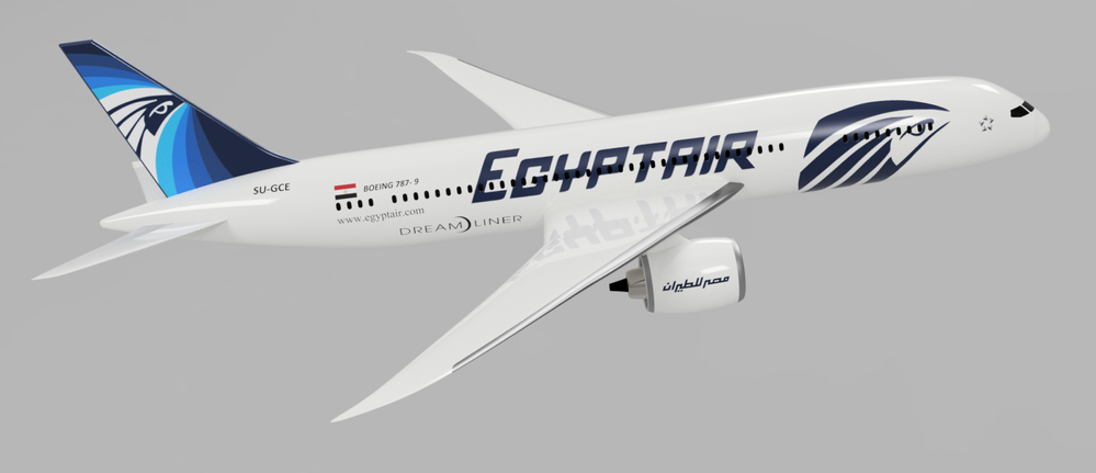

Hello-
I'm having problems with how certain decals render in cloud/local/in-canvas (especially with "Egyptair" and bird decals). I'm wondering if there is a way to solve this.
Link to the project: https://a360.co/3bewwsn
(P.S. The fuselage is made using a t-spline then thicken inwards)
How the decals look on my screen before renderingHow the decals look on my screen before rendering
How decals looks after renderingHow decals looks after rendering

In this case it's tough to say. I'm going to log a case for it. T-splines can sometimes be trouble for decals. This is a good example.
Looking at your model, I first did not find a row of windows, but also the decal was not following the "chain faces" rule.
  • I deleted the failed split operations in the timeline.
  • Then split the fuselage body into three sections.
  • Then reapplied the decals to the correct bodies. (the placement in my image may not be perfect, see below)
  • Render again - and it worked well.
One thing about Decal is it doesn't like "holes". In the model, the windows are all cut out and this will distort the decal. Fortunately, your model allows you to work around this. My suggestion is to do two things: make every window a body, and make no holes in the bodies with decals.
I used extrude surface, boundary fill, offset face, and pattern, to produce a row of windows without making holes in the fuselage. The key is to offset the window face a few mm to make it stand out from the decal surface.
Please let me know if you have questions, glad to help! Here is my rendering result:

You are correct, t-splines were the problem. The decals however, didn't interfere with the windows as I disabled chain faces and just selected the faces each decal needs. But your methods for the windows is much better IMO and avoids the random errors that occurred to me.
Another workaround I found was to close off the fuselage t-spline and it will turn solid. That seems to fix the decals and the visual glitching that happened sometimes for me (Although this isn't what a fuselage should be realistically).
Render of the workaround solutionRender of the workaround solution
