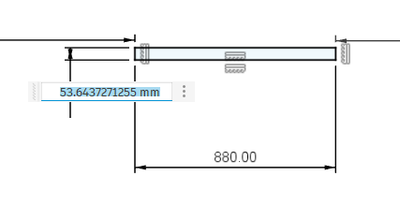

Sorry for the bad title, I'm working on a basic shed model, the back end of the wall is 2.4M tall, and the front end of the wall is 2M Tall, so i want a sloped roof, i made the struts up, then made them all 2,4M tall, then i was going to just cut the angle, however when I cut the angle it made the angle but also made all the lumbers short?
How do I cut the roof?

TheCADWhisperer
@pingthehood
Are all of your sketches fully defined?

TheCADWhisperer
@pingthehood
Your first sketch is missing two dimensions and one geometry constraint.
When I add the missing dimensions and constraint - observe the red lock symbol on the sketch.
Also observe that the unconstrained sketch geometry has changed color.
The second sketch does not appear correct.
I drag the endpoint of the short line from image above to connect the rectangle and add the missing dimensions.
I would have modeled with symmetry about the Origin and Mirror Component rather than copy and move body...
The third sketch is missing a dimension and when I add the missing dimension the current geometry size does not make logical sense (that is one reason we fully define all sketch geometry).
Sketch4 appears to be empty.
Sketch 5 is missing a dimension and a position constraint.  When I add the missing dimension, it does not make logical sense.
Sketch 6 is missing a constraint (or dimension, I would use constraint).
Sketch8 is missing a Constraint or dimension.  If I dimension - it does not make logical sense.
Sketch15 is missing a dimension and appears to be way off.
Another sketch that appears to be off...
This is Sketch16.

TheCADWhisperer

pingthehood
No i removed it just before saving, its literally a sketch on that upright strut and drawn to the angle of both, and extruded to cut/boolean.

davebYYPCU
Don't have to cut them if you use Extrude to Object.
See if this make any sense.

@pingthehood
One simple sketch (see Attached).
