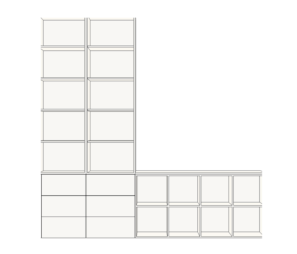

Hi all,
I have a perspective view in a drawing which displays fine when initially created...
However, if I change the scale it is cropped....
And ends up like this...
Any ideas why this might be a thing? It only seems to happen in the front perspective view and with this particular model.

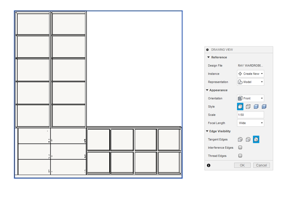

You have your Focal Length set to Narrow in your Prospective View.  Change this to Wide or create a new scaled view before changing the view to Prospective View will help you out.

Thank you for your reply.
Unfortunately choosing wide focal length doesn't seem to make a difference.
So this is the perspective view created at the native scale (1:50) and with wide focal length...
And this is it scaled to 1:30...
And this is the result...
Also I may be missing something, but how do I create a standard view and then change it to a perspective view?
Cheers!
