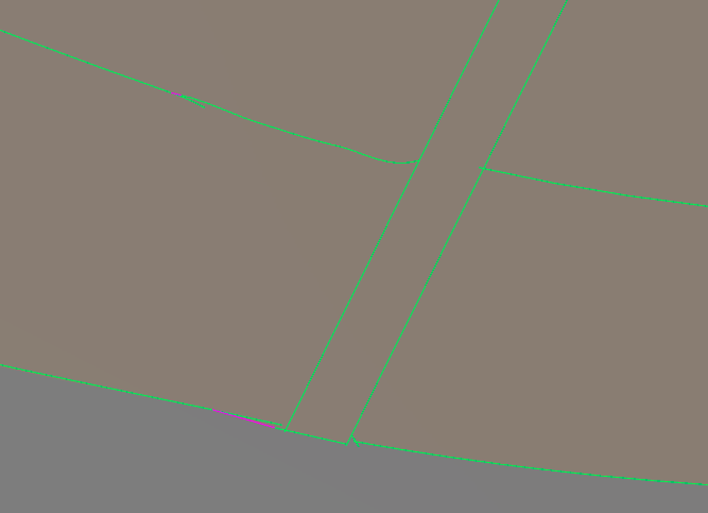

The purpose of CAD is rally accuracy and precision. Whether this is because you're original imported geometry was already imprecise when you created it or if it got altered during the export/import process is hard to determine.
It is advised very often not to create these simple things in another vector graphics application but  with the sketch tools in Fusion 360, It might be cumbersome and slower do do so but provided you make use of constraints it will have a much higher chance of success.
What I see in your design does not look like proper sketch and it is no surprise that the sketch engine does not recognize certain profiles for extrusion.

Your import was rubbish - so I would go back to sketching in Fusion.
You do not (and should not) need to sketch all of the geometry in one sketch.
Think of each piece boundary as a "layer".
You can create each sketch for each piece layering them by Project Geometry common boundary edge from previous sketch. I have a general rule of 7-10 entities per sketch. (Not a hard and fast rule set in concrete, just a guide.)
Following that procedure - I don't see how it could possibly take any longer to trace the image in Fusion than it does in any other program? Does the other program (incorrectly) find the edges for you?
I see about 30 minutes of work.
