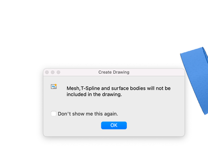

The create drawing dialog does not respond to mouse clicks, neither 'Don't show me this again nor the OK button.
The only thing that removes the dialog is the Enter key.
Fusion 2.0.13881
Active Plan: Fusion 360, Subscription
macOS 12.3.1 x86_64 (21E258) on MacBookPro15,1

Message 2 of 9
pmbouvier
Forgot to mention.... the cursor turns into a watch icon when hovered over the dialog.

Hi @pmbouvier
That dialogue will only appear when there are T-spline bodies, meshes or Surface bodies in the model.
If you remember which model caused the problem initially, please send it on to me, and I'll ask the team to investigate.

pmbouvier
It works for me too now, Clint; I can't get the dialog box to come up anymore.  If it happens again I will re-open this thread.  Thank you.
