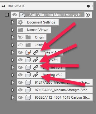

Capture a screen capture of your model Browser and post it, do you see any "Paper clips" like icons?  These indicate external linked files.
John Hackney, Retired
Message 16 of 33
kvlasblomQYQWD
Yes, I have 31 components that I designed separately.  Should I break the links?
