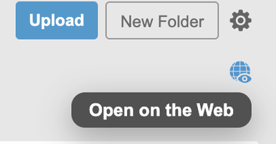

To work around this, I using the Web project interface by Clicking on the "Open on the Web" button in my folder.
