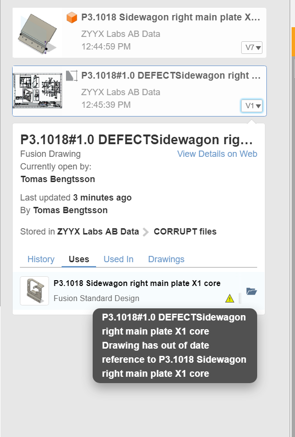

tomas.b
Unfortunately, it does not work at least for sheet metal parts.
If doing a "copy with drawings" and then renaming the two copies, you can see that there are external references between the new files, but the sheet metal part inside the drawing keeps the old name.
And the file browser says "out of date reference" as shown in pictures.
