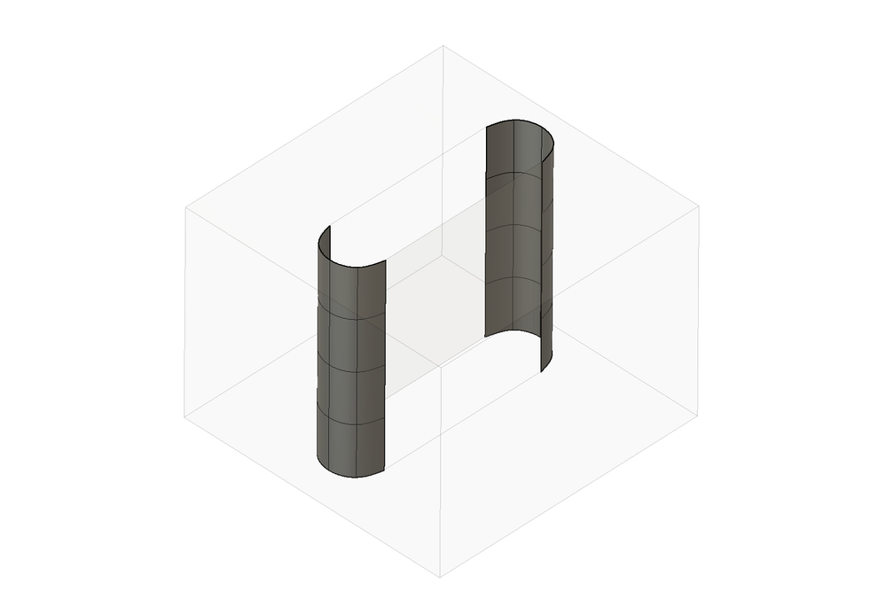

I have been using this feature for a long time, and it has been working perfectly.
After the last couple of updates I am getting very strange results when converting really simple BReps' to T-Splines. See attached screenshot. I have made a simple body using the slot function in model, straight up and down, nothing fancy.
When I try to convert the curved face from BRep to T-Spline, it inverts the curve of the BRep going the opposite way (Blue colour is the face that is there in the BRep and should turn into a T-Spline, however, as you can see the T-Spline surface goes the other way.
Any workarounds or hints?
Thank you

jeff_strater
I don't seem to have that problem.  Can you share the model where you see this?

Hi Jeff,
Procedure:
1) Draw Slot
2) Extrude Slot
3) Surface - Create Form
4) Convert BRep to T-Spline
5) Select Curved part of Extruded body.
See result in model:
https://a360.co/3Prfe0q
AnnieBx
Yes, that was what I have been seeing and expecting as well, for a long time. I have made a PDF to demonstrate step-by-step. Believe me, I have made many complex shapes using T-Splines in F360, and always been happy. I find any workaround or solution to this. Model is shared here: https://a360.co/3Prfe0q
AnnieBx
You are making a slot in a cube, which is not what I have been doing. I am making a slot to make a body shaped like the slot. As I said, I have been doing this many times to get a basic shape for T-Spline/Surface modelling.
jeff_strater
ahhhh, thanks for that clarification.  Missed that.  Yes, that is a problem.  I created bug FUS-152528 for this issue.  Thank you for reporting it
