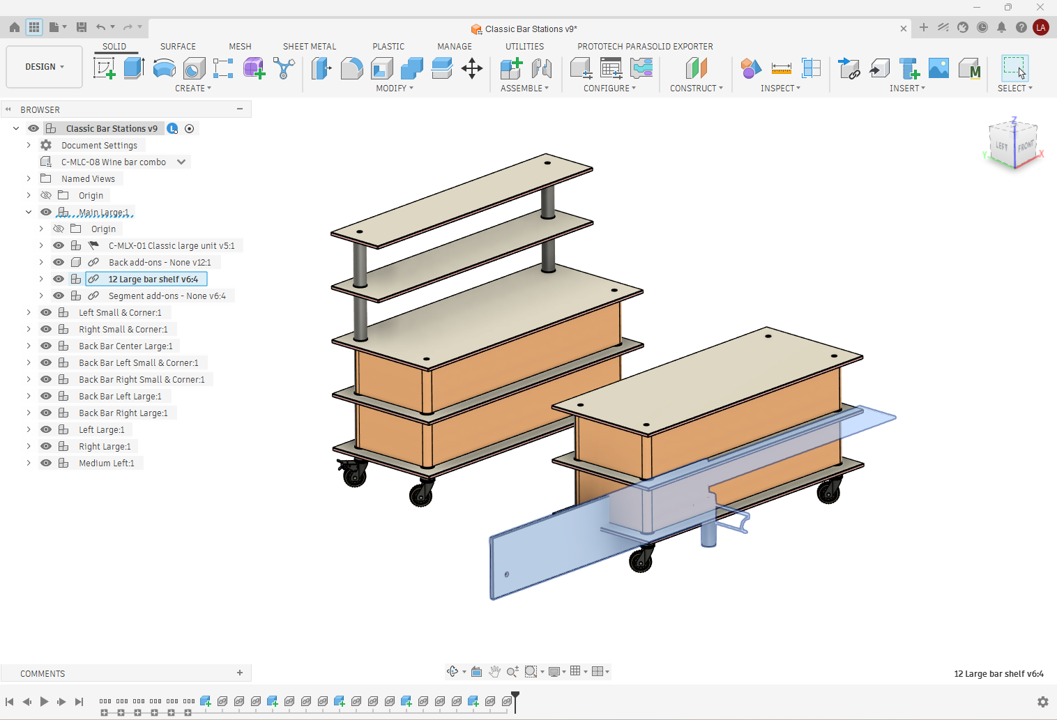

So I have been working with configurations for years now, never had this problem before. It seems that in new configured designs I create component locations and joints break when switching between configurations. I tried adding joins, creating rigid groups, saving as, re-inserting components, event clearing cache - nothing works. Ctrl+B works, until I change between configurations again. I am at my wits end. Does anyone have any experience with this scenario?
Additional information: The problematic components are all within linked configured components. The inserted configurations, when opened separately, are not affected. Seems that only "second level" components are affected. See the attached screenshots.
Thank you

Hi @gautham_kattethota
So some interesting results: when dragged around the inserted component doesn't snap back to place, but the sub-components do rearrange to their relative positions (in other words, the shelf comes back together but does not snap back to the table). If I click Compute it goes to the correct position, and if I click Revert Position it goes back to the weird dismantled position.

I think I found the culprit - Inserting the external configurations into sub components (acting as folders) in the main configuration.
When I opened a new main configuration with all of the inserted externals in the main tree - no more jumping around!
This makes the file less intuitive to navigate - given all the suppressed components. I make do with selection sets for now. But this seems to be entirely solvable - hopefully in the near future?
